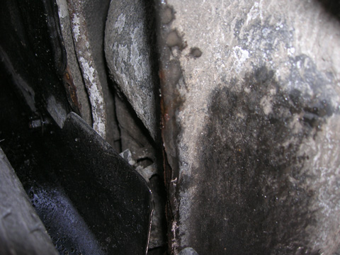

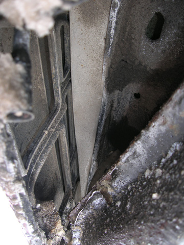

    well, i went under the car today because i could smell gasoline in the rear all of a sudden. lookie what i found isn't it pretty?
    pretty enough to make a grown man's eyes water i'd say...
    do i have a choice between plastic and metal?
    looking around on the web is very disheartening - any tips on how to minimize the financial damage involved in replacing a gas tank?

    I had mine fixed for the same problem for much less than a replacement. Norbert of BM Service Exclusif in Montréal did it for me. I don't think it was much more than 200$, if not less; I forget but I know I have the receipt.

    I was just about to buckle up and take the car to a place that was recommended to me on Industrial Ave that does that - they quoted $350... I called Norbert and I think I'm going to take it to him tomorrow instead - actually he's almost next door to a good mechanic I know (who recommended the other place tho) and I guess they know each other. Nice tip!
    I'm kind of worried about having crap in the tank tho. An exterior repair wouldn't fix any corrosion on the inside that could really screw things up. I thought I was having spark problems because of a cranky alternator but now I'm wondering if there's a whole bunch of crud in my fuel tank causing my minor idle issues. I replaced the fuel filter in September and it was dirty but not filthy, if the tank got badly contaminated it's only since then. I guess if the new filter is still clean I could be fairly worry-free right?
    Norbert says he'll replace or send for repair as I say... I guess the moment to decide will unfortunately be after he's already dropped the tank.
