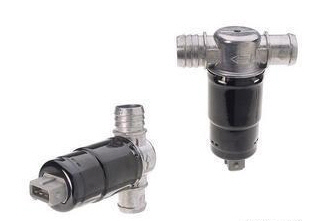

    Tiger,
    When I started my car this morning the idle started jumping back and forth between 1,100 rpm and 400 rpm while in Park as it did last night. I did what you said and it looks like it did the trick.
    The ICV is somewhat pricey. Do you know if I can spray throttle cleaner into the two hose ends on the ICV to clean it, or will I have to purchase a new one?
    I have attached a picture of what the 1990 525i ICV looks like. It is mounted on top of the engine in plain view.

    Perfectly do-able. Just take it out spray it in both ends and let it run out and it'll work better. Worked for me too when I had similar symptoms. That was a year ago and it still works fine.

    Replace the hoses if they need it, check to see if they any cracks anywhere, while your at it check ALL the hoses for any vacuum leaks as it will contribute to your rough/searching idle. Take the ICV out of your car and when you spray the cleaner in the ICV, shake your wrist back and forth fast enough to help move the little gate more freely. Sometimes the ICV is actually bad and you will need to replace it, but it doesn't hurt to try cleaning first. It's when you go to purchase the ICV that hurts.........
