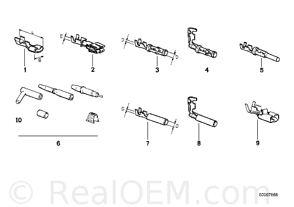

    thanks, but let me get a pic to show you waht i mean, i'm not looking to replace the plugs but the pins themselves for the rm, gm, and everything in the rear fusebox
    for these kinda things, lol
    thanks

    Of course you can also change the pins, just buy them, there are pins with some cable on it already from BMW, check the realoem for that. Easy to resolder.
    Or buy solder sleeve. They come in butt splice and terminal options. No crimping needed
    how to install ( be patient takes some time till the vido comes)
    http://www.delcity.net/delcity/docum..._terminals.mpg
    where to buy, more info
    http://www.delcity.net/delcity/servl...=791842&page=1
    BUT, to get the pins out of a socket/plug, you need a pinout tool, as these pins have hooks which hold them in place. So make one as I showed above.
