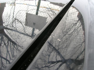

    here's some pics- what do you think? can't figure out how to focus - they actually look a bit worse in the photos than they are. he thinks it's the original water pump! (also you can check out the mess they left on the carpets here! not so bad for this filthy city actually)

    Default Observations
    The impeller on the pump doesnt look plastic. But if it was shot, then it was shot. Cant do any harm having a new one in there! The scratches look like someone was at your car with a chainsaw but they cant be that bad can they? Maybe its the pic or my eysight but does that valve head look bent? If your mechanic is half as bad as everyone thinks, you probably got off lightly. Main thing is you got the car back, its running OK. Its not even my car and i'm relieved you got it back

    Quote Originally Posted by whiskychaser
    wait...a...second.... omg it would suck if i got wise to this too late, i was ready to go to bat. yes the valve is bent- wouldn't it have been making pops and stuff if the valve was already bent like that when i drove it to the shop? damn i'm slow sometimes. i think the impeller was metal originally on the pump for my year - not sure. thanks for the support - don't think you could be near as relieved as i am to have it back- although i'm going to have nightmares about what else this guy did to it. crappy crap crap crap. i'm thinking could have been way worse and hopefully isn't . damn. crap- yeah i'll use a tow truck next time. damn- i think i'm going to be pissed for a long time.
