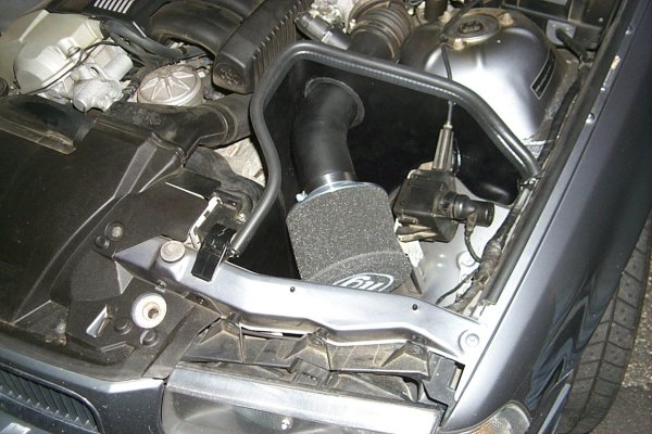

    i also suggest if you take K/N filter or any other - you should build CAI - cold air intake...the idea is to make a wall between the filter and the engine bay.
    it should look something like this:

    Quote Originally Posted by filip00
    what material did you make your wall out of? it's important to make sure that it doesn't conduct heat.

    I believe it comes with the black steel(?) partitioning wall? Not certain. I'll let you know after UPS drops it off tomorrow. Looks good though for a CF intake.
