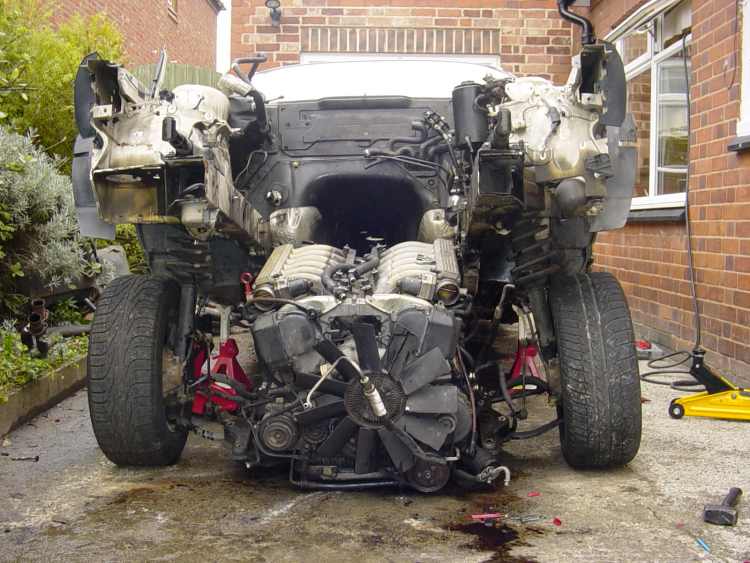

    O.K. here the next one: car was completely stripped. Problem was that the truck to pick it up was too large to enter the year. So we moved the chassis on the frame of the engine lift and 2 hydraulic jacks, actually it worked later with only one hydraulic jack, nicely balanced.
    http://www.bimmerboard.com/forums/posts/278693/

    Regarding these pix.......I am about ready to pull an M50 with 5-speed from my donor car....and this is very similiar to the way I envisioned doing so. Rad. core support etc removed,car braced just so.....the pull forward the whole assembly.
    Is there a better way even still ? Or is this just as well ? I wasn't going to need to ROLL it as you've done...so the crossmember and suspension were going to be remaining for this project/point.

    you are out here, winfred, this is a shade-tree-mechanic competition, not professionals
    rolling out a V12 engine if you have no engine crane
    Quote Originally Posted by BigKriss
    I've never thought of doing it like that.
    I was told so by one member of the U.K. board, which is dealing in used E32 parts. He said that is the fastest, if part a car and do not have a engine crane.
