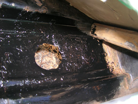

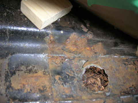

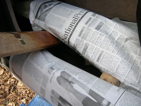

so my carpet has finally dried up from a previously blocked sunroof drain and i am using today, the last day of fall here methinks, to paint the floor underneath.
not a brilliant job, but i sanded most of the rust away (hard to reach down there!) and it won't get wet now so i'm hoping it makes it through a winter or two before i actually have to put in a new piece of floor.
considering the drain was probably blocked for years without the po doing anything about it i think i'm pretty lucky to get away with such little damage. i had no idea about this when i bought the car so i figure it could have been a lot worse.

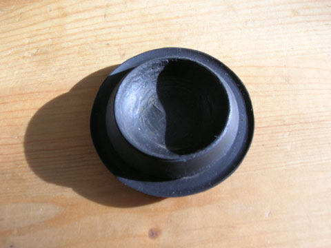

the guy who's going to fix the front 1/4 damage you can see in one of the photos gave me a plug to use in the hole- said he pulled it off a ford somethingorother but it should fit... and it does. i thought that was strange but i'm not complaining. posting photos seperately incase you don't want the mbs...
