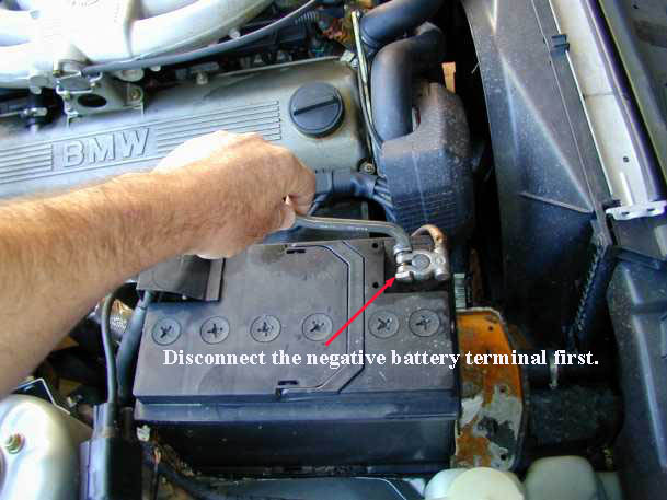

    1. First you disconnect the negative battery cable. This is critical. Make sure you have the code for the radio before doing this.
    Its very important that you disconnect the battery before doing anything else, if you don't you will trip the airbag code when you turn the key to remove the
    steering wheel... I have had many many emails from people who didn't do this and now want to know how to turn the airbag light on the dash off...

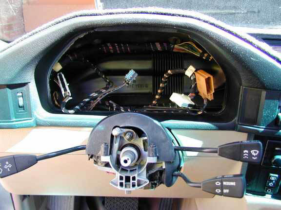

    Then you remove the 22mm self-locking nut that holds the steering wheel on. This nut is to be replaced as it's only intended to be used
    once. The torque when reinstalling is 59 ft.lbs. Once that nut is removed, mark the steering shaft and the wheel with a marker. A line across both so you can put the wheel back on in the same place. Put the key in the ignition next and turn to the run position. The wheel will then lift off.
    Once the wheel is out of the way you remove the 2 philips screw that are in the top of the instrument cluster and carefully pull the
    cluster out far enough to remove the wiring connectors on the back. There are little levers you raise to release the connectors.
