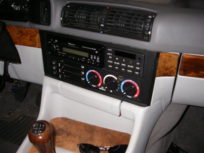

Here's a few shots of my stereo install. Still a few loose ends to tie up in the trunk, but it's getting there.
Blurry shot of the NAK CD400. Looks good in the dash.

Is the stereo a standard size? because I'm considering ditching the stock cassette player and getting somethin newer
-Mike
Highly recommend yanking out the stock head unit. I just installed a JVC KD-G820 that I picked up at best buy. It was originally 259, marked down to like 190, I asked the dude if I could have it for 100, his manager said sure. $105 out the door and it rocks. Stock speakers, ran the sub out to my sneaky pete in the trunk, and it sounds pretty damn good. No doof-doofing from the trunk, just some decent low end.Originally Posted by Sam-Son
Anyway, you'll enjoy the features of a new radio, trust me.
Yeah my father just got a new radio installed in his '91 Alfa and I looks really clean and it has an Ipod jack. he bought it and intaled it all for less than 200 at circuit city. I'm seriously considering doing the same once I get my car backOriginally Posted by Bin_jammin
-Mike
Before you decide let me take some pictures of a new head unit we are carrying at work, its kind of hard to explain but, I will take some pictures tomorrow and do a dry fit in my car or Snakeyes' while at work and see if it does fit
But its a 4.5 or 4.8" touch screen controlled 1 din head unitthe whole removable face is about the size of a older game boy advance, so the screen is part of the face plate, dont have to worry about motors going out for a motorized screen. Thinking about getting one this paycheck since my older JVC just needs changing out for the sake of change.
