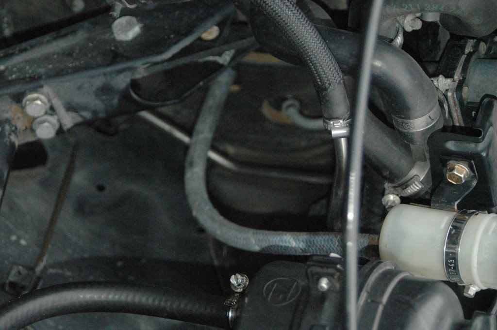

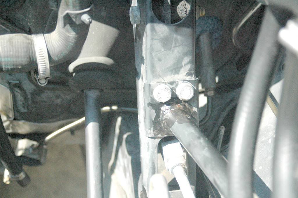

    If you are not getting a package deal like I did on my 6 speed conversion you need to buy the hard clutch line and clips from the dealer. Check the etk for part numbers. The auto does not have a reverse light switch. It is part of the wiring which goes from the auto transmission to the ecu box. I spliced a wire from the shifter to the reverse light switch on the 6 speed. I used a generic two prong Bosch connector I saved from a SAAB 9000 I wrecked a few years ago. You can get the connector from AutoHauz I believe.
    The jumper wire is to supply power to the ignition switch in absence of the auto shifter. The bottom two wires go to the reverse light switch.
    Picture of the master sticking out of the fire wall and the hard line connected to it. A clip is on the bottom left of the picture.
    The clutch fluid reservoir.
