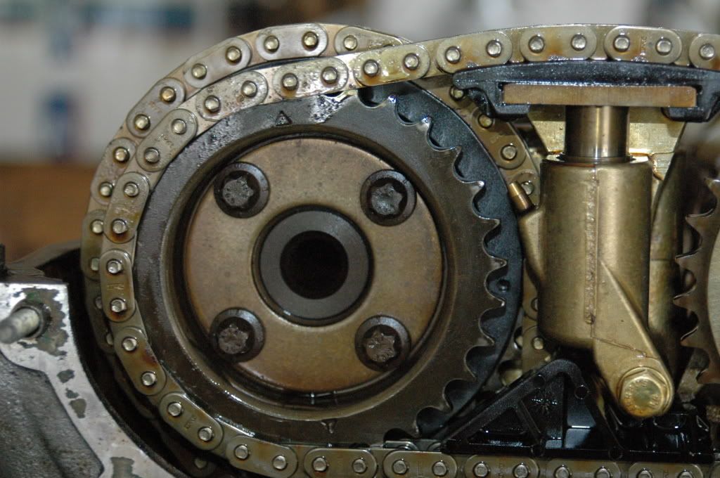

    Call me , but looking at this photo, I'm sure I can see the intake cam is visibly out of time...
    The square lobes at the back of the camshafts dont look like they're dead parallel... or is that a perspective trick of the camera or a vanos trick?

    Quote Originally Posted by Ferret
    Looks way out to me too. But I'm sure its not. Er...is it?

    Quote Originally Posted by whiskychaser
    Are you too?

    Reading, UK
    1,853
    Quote Originally Posted by yaofeng
    Are you too?
    You're welcome.
    We were actually after a shot of the back end of the cams, the two square blocks that you're supposed to use to set up your timing.
