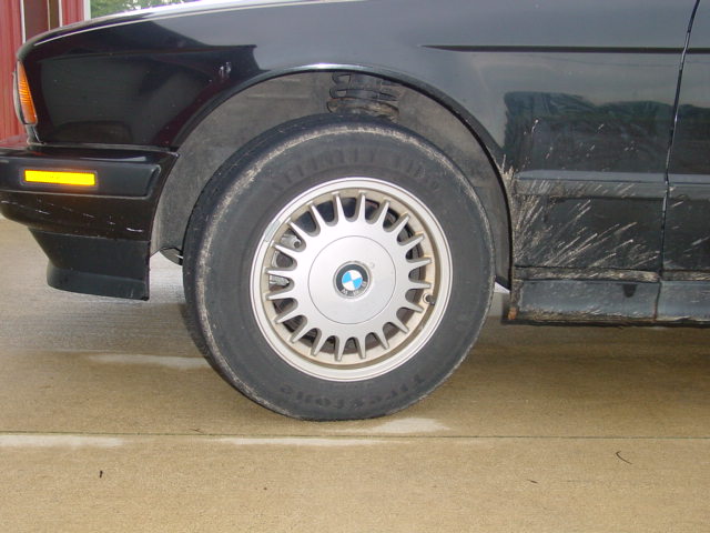

A few weeks ago I looked down at my front tires and noticed that I had major wear to the outside of the tires. I changed both upper and lower control arms about 18 months ago and since I do not drive it much anymore, I have not really payed attention to the tires. Plus it drove dang straight after the job. I posted a picture of the tires.

The ride height is 23 7/8" on the passenger side and 24 1/8" on the drivers side which is higher then the 23 1/8 that the Bentley manual calls for.
Before I go put new tires on, I need to fix the camber problem.

But, it was or is my understanding that camber can not be corrected?
Only the toe setting is adjustable.
Yeah, this looks like an excess toe-in on turns problem, not a camber problem. You may have noticed a little tyre squeal on slow corners, such as in a concrete floored car park. Essential after carrying out any parts replacement on the front suspension to have the alignment checked and adjusted, as the last alignment would have had to compensate for the wear in the control arms. With no slack in the new bushes, the front end geometry will have been altered. Of course, you may have also stuffed your new thrust arm bushes by not having the suspension loaded when you tightened up the through bolts.
The ride height could have been affected by the bushes being preloaded - that is, if you tightened the through bolts with the suspension hanging down, the bushes will be trying to restore the angle of the control arm to the unloaded position.
