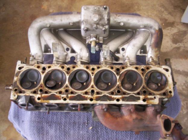

Finally, the head is off... This took me several weeks of working for very short periods of time by myself. I was quite surprised at how "light" the head / manifold combo was. I expected quite a bit of weight, but I was able to move the entire assembly around by myself once it was off the block. I did have help removing it though. There is no crumbling of the metal on either the block or the head. I will admit that I am very glad to have this stage completed. I was quite afraid that I would pull the head off only to find carnage as per a recent thread... I know I am only halfway there, but I am so glad to be where I'm at. I am taking the head to a feller here to have him put new seals in, check the valvetrain out, pressure test, and skim if necessary.
