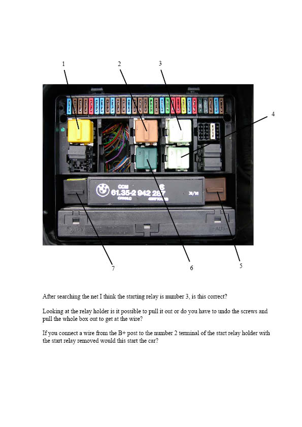

    Default starting relay
    Hi
    I have a couple of questions about the starting relay.
    pls see attached pic
    many thanks
    steve

    I've got some photos (I think!) of what I did - I'll see if I can dig them out - I'll hopefuly post them tonight.
    Off the top of my memory, I think the relay was the one that you have numbered 6 (which, rather confusingly, also seems to be embossed on the relay itself with number "3"!).
    Great Britain
    446
    Alas no photos - you might have to wait till the weekend before I get a chance look into this to work out which relay.
