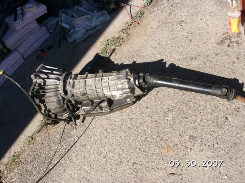

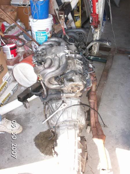

    Tranny off:
    Itake manifold and valve cover off:

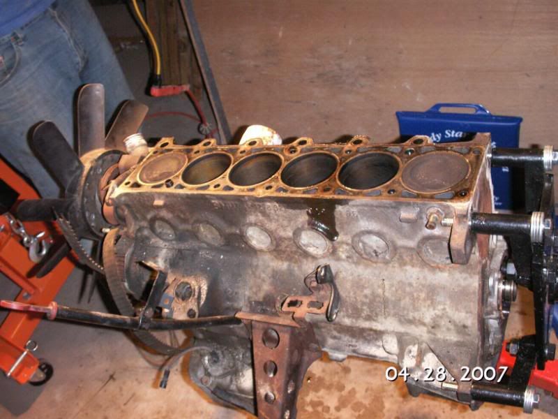

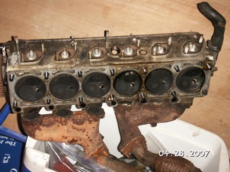

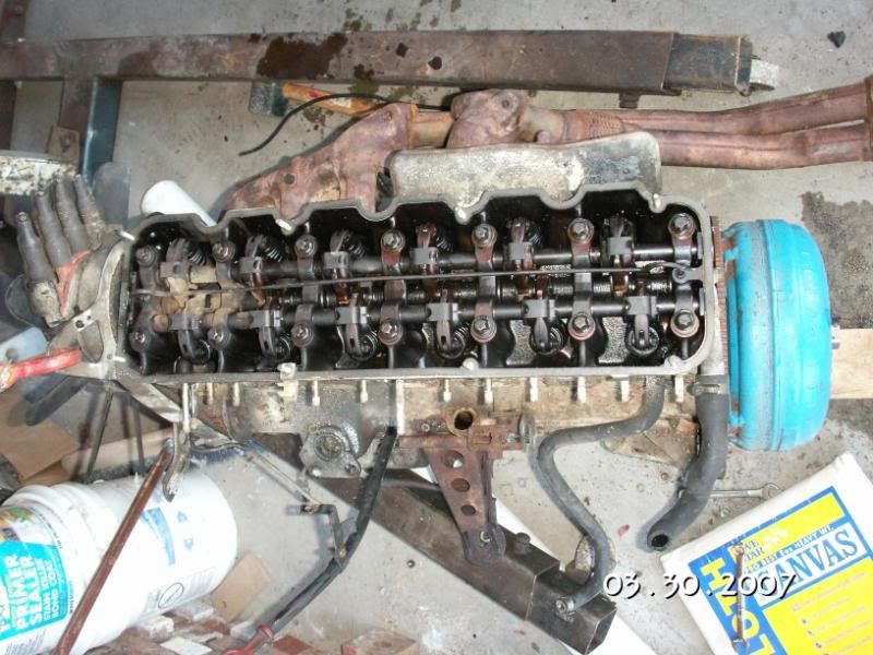

    On the engine stand, head removed:

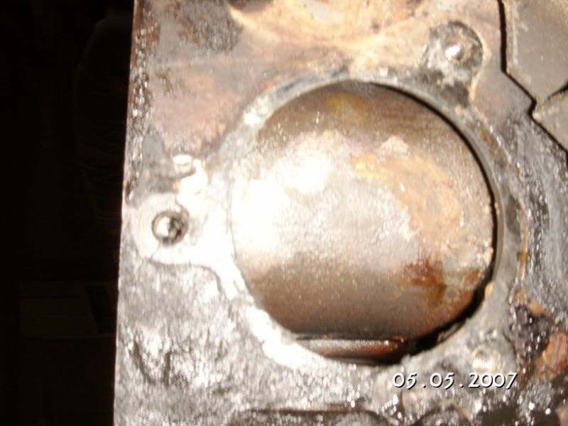

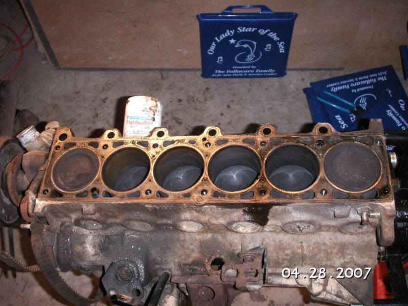

    The cross hatching (or w/e it's called) in the cylinder walls was surprisingly good looking.

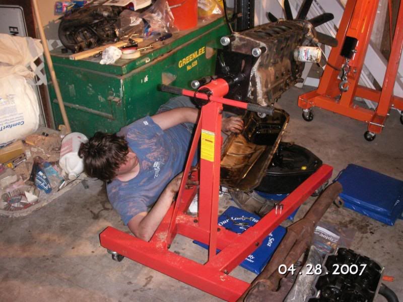

    Oil pan and pump removal: (Sorry I look like a slob lol)
    Removing the pistons:

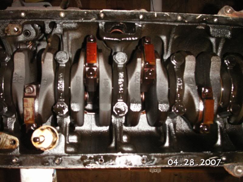

    Crank looks decent:

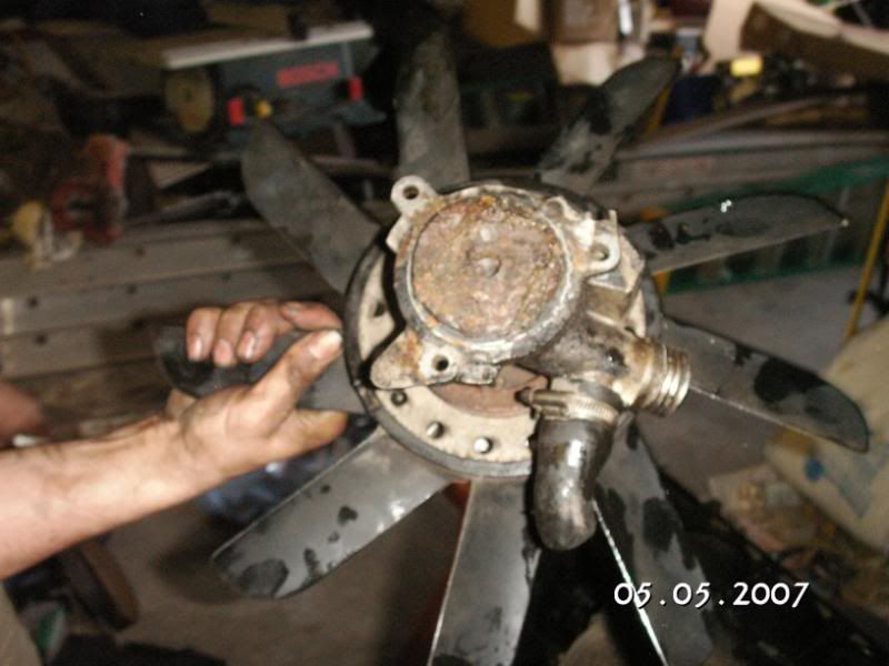

    Water pump completely trashed. Look at all the sediment build-up.

    BTW, you don't need any specialty tools to do the fan clutch- just an el-cheapo 32mm wrench- grind the face of it to be a little thinner than as delivered, and that will work better than any specialty tool you can buy. I've also heard that you can find decent 32mm thin wrenches at most bike shops- they're used on the steering head or something like that. You can also get by without the crank lock tool if you want to.
