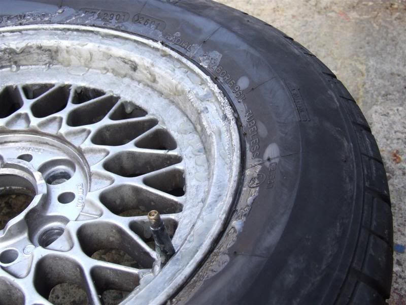

    Started with Nitromors (paint stripper), got all the paint & primer off the lips.. unfortunately the rims are a 'crinkle' finish under the paint, so out with the 120 grit paper to smooth them down.. This was the hardest part of the whole process - more just time consuming than real hard, but it'l give your arms a good workout!

    The first set of wheels I polished were the old metric basketweaves, paint stripper didn't do a thing except make a mess, so I had to sand them all..
    These wheels, the paint almost fell off!
    Nitromors on - dab it on, very thick, rather than brushing it on.. This was after a couple of mins, you can see paint starting to lift at the edge..
    Leave it 20 mins & remove with a scraper/wire wool... You'll probably need a second application to get it all..
