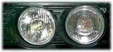

    4. ++ Can I install HIDs in my car?
    Yes. HOWEVER! If you have FREEFORM headlights, PLEASE don't do it. For us, that means your low beam must have a lens inside like this:
    http://www.bmwe34.net/E34main/Mainte...ht_picture.jpg
    See that 'fisheye' round type lens in the middle or the right lamp? That's the projector lens. See the highbeam lamp on the left? It's freeform... simple?
    The projector ensure that the light cuts off cleanly and doesn't glare other drivers. Ever seen an oncoming driver with their highbeams on?
    Yeah, that's what it would be like if you put HIDs in freeforms, except 100x worse.
