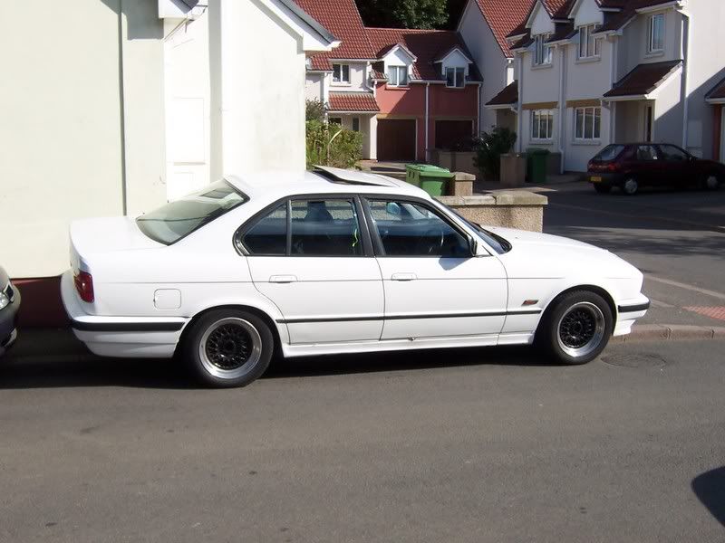

    I'm assuming you mean the ones that go in the front wings?
    They were standard fit in UK/Euro markets..
    (Although they look better where Dave M has his Hadn't thought of moving mine!)

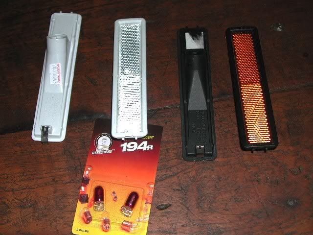

    sidemarkers are in the rub strips, and they work as parking lights only. The markers in the fenders are repeaters and work only as blinkers. You can get the smoked/clear repeaters from Bav Auto and clear side markers from Pro Car Parts, but the outer edges of the sidemarkers are plasticized chrome or white and will have to be repainted flat black to look like mine here
    old and new sidemarkers here
