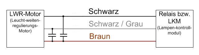

    They draw too much power. There is a newer version with a white spot on the housing.
    Or install a 4 diodes
    http://freeweb.siol.net/caposiol/1n4007.jpg
    4 Diodes 1N4007
    Here something from the German E34 forum
    http://www.induleo.com/e34/lwr0.jpg
    http://www.induleo.com/e34/lwr1.jpg
