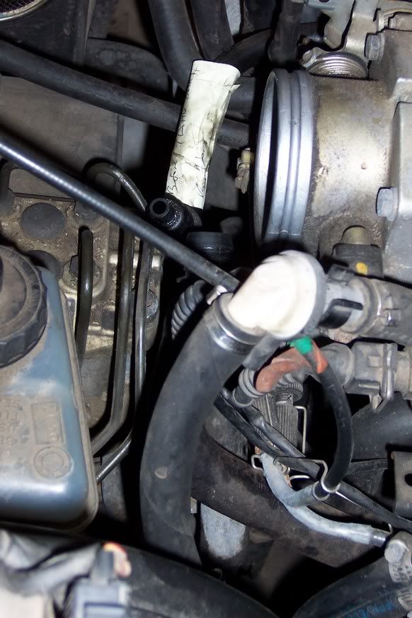

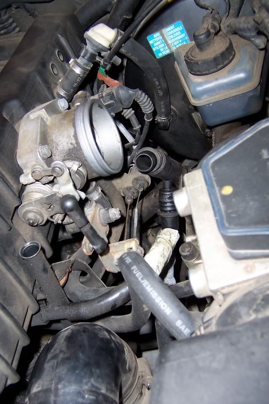

But on most any other car I have worked on, there is a hose going from the intake to the brake booster, rounds thing up against the firewall, that provides vacume to the booster. If you take that off, the booster side, there should be suction there. Pour in your cleaner till she dies.
Pics of the brake booster hose. Just to the right of the throttle body.

Thank you! I guess I should use that vacuum hose to get the cleaner in there and then wait 15 minutes before running it out. I have wondered about that ugly elbow connection on that hose before. Is it some sort of vaccum regulator or something??? It must be. BMW would not arbitrarily put that in there for no reason when they could have used a continuous vacuum hose instead.

That booster brake line I am going to use to apply this kit looks rather fragile with all the joints and crimp clamps. Any words of wisdom on how to remove that for the application without breaking anything?
