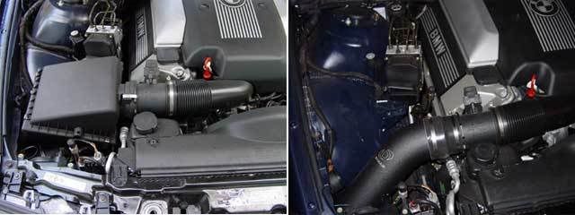

heres a summary of what ive been talking about, if its too chopped up you can refer to the original threadhttp://forums.bimmerforums.com/forum...d.php?t=690267
The High Flow Cold Air Intake System develops horsepower and torque gains for faster acceleration and improved throttle response. The performance intake systems have been designed to provide improved intake airflow at the lowest possible temperatures, for greater engine efficiency and resulting power gains. When combined with Stage 2 Performance Engine Software, power is increased by as much as 20 horsepower and 20 LB/ft torque.
The High Flow Cold Air Intake Systems replace the factory air box with a large cylindrical K&N filter and 4 inch diameter mandrel-bent aluminum intake pipe. The filter is relocated to a separate compartment behind the front bumper and below the headlights in order to insulate it from engine compartment heat and maximize exposure to cooler outside air. Stage 2 Performance Engine Software is required which optimizes the fuel mixture and ignition timing for maximum power gains. If you already have Dinan Software in your car, it will be upgraded at no charge when you purchase the High Flow Cold Air Intake System
STOCK/DINAN
(image isnt working)
Im thinkin about goin down the local Muffler shop and having them bend a 3" aluminum pipe for me that is a somewhat replica of the dinan; then putting a K&N Cone filter from a mustang on the end of that...

Actually - I have read that the CAI on the m60 engine actually loses power in the midband. The airbox on the 540 is actually more efficient than the CAI advertised out there - yes even better than Dinan. Additionally - the Oil from the KN Filters will foul the MAF causing damage to it and create bad readings and inputs to the ECU.
This is my opinion. I would do an EAT chip and exhaust - there are negligible perf gains there. -JT

i have completely taken out the air box, and its design is extremely good. the only thing i can see to make it better is to put a ram air CAI into the bottom of the box, and maintain the stock filter setup.
the efficiency has to do with intake pulse damping or something

On the 535 there is a venturi that collects cold air directly from behind the headlight area - "ram" air as some call it.
It empties into a large box with a large filter. My fluid dynamics is a bit rusty, but I believe this does two things: 1) The air accelerates in the venturi, resulting in more flow than you would get with a straight tube of the same diameter. 2) the big box acts as a capacitance in the air-domain, keeping the supply of air to the throttle relatively consistent even as the load, throttle, speed, etc., change. In contrast, a long tube of air is more of an inertia element, which is not as forgiving to changing demands.
Chances are good that the engineers at BMW tuned the intake to be the optimal air delivery system for the stock engine, or even an engine with a chip (I don't believe a chip increases the air demand, just pushes the timing up to extract power closer to the detonation limit). And by optimal, I mean that anything else will by definition deliver less power. There are pretty sophisticated models + testing they can do to tune it exactly to give the best power range over all expected operating points.
Unless the head has been opened up and/or the exhaust has been changed, I don't imagine there could be a better setup than the stock. I had a tube and a K&N on my 535, and while it sounded meaner, it didn't have the consistent power the stock filter did.

a cheep thing to do is just remove the pipe that the airbox attaches to, the hole in the end is much smaller then the rest of the intake tract, the airbox will still suck fenderwell/bumper air, the difference between the snorkel size and the rest of the system is almost like a golf ball vs a tennis ball. you also are raising the intake a couple inches reducing the m60s tendency to suck water, i've changed more m60s due to sucking water and hammering the rods out the side of the block then anythng else

The stock airbox for the 540 is actually better engineered that these CAI.
The Area of filtration on the Stock filter is much greater than any KN Cone Oiled Filter. It you have a greater area for Air to enter the system at the filter - then do you really need to have a larger hole for air to flow into the box?
The Oil from the Stock filter (Oh - wait I forgot there is none) wont foul the MAF and screw up the inputs the ECU needs to process correctly.
The KN Filters allow more particulate into your engine - that is how they achieve any results they claim. There are websites on the net dedicated to the damage these filters can do. So if you are allowing more particulate through a smaller filter on the end of a restricted tube - are you really increasing the airflow? or just compensating for removing the Stock box.
Last Thought - I would love to see your results of doing this. It sounds like you are into it - so hey if you are going to do it - lets document the results. If you have heard it 100 times and dont believe it here is what I propose.
Go do a dyno pull - tomorrow - bone stock and save the results. Then add your CAI or anyone else's - heck Have Steve Dinan sign one and send it over install it and then go back and do a dyno pull. Save the results. and then Please post them here so we can compare the two all know once and for all. I for one would love to be corrected - AND - I will publically state my ignorance on this subject moving forward. Thoughts? - JT
