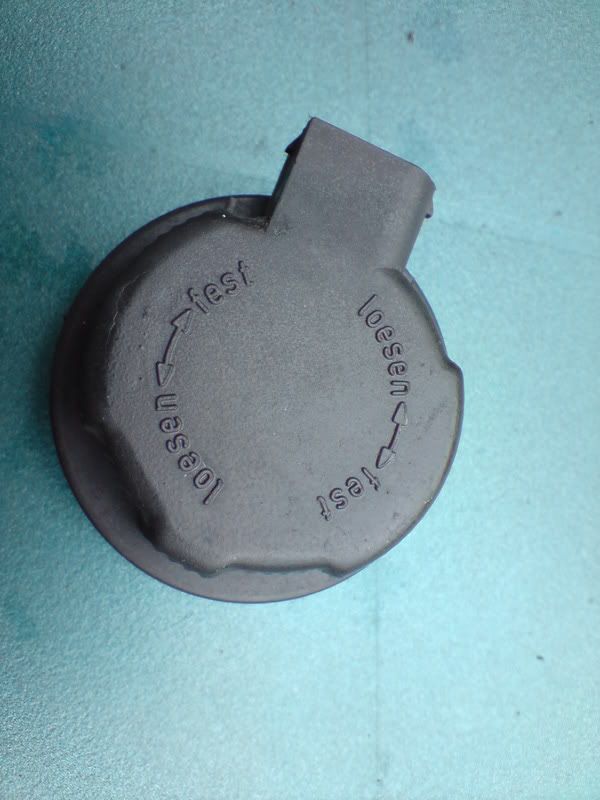

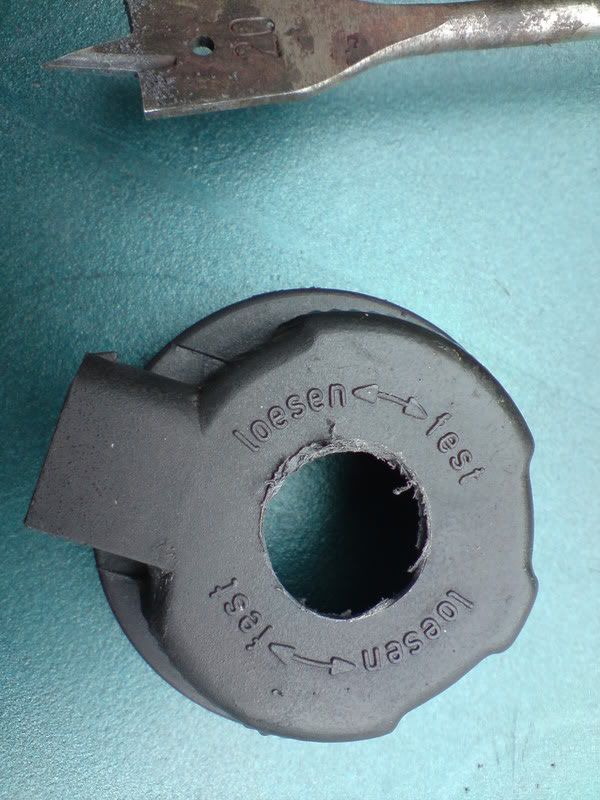

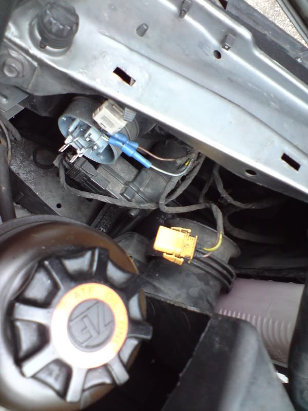

    Unplug, twist and remove the cap for the headlights and get drilling
    Craig

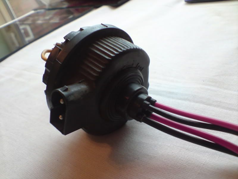

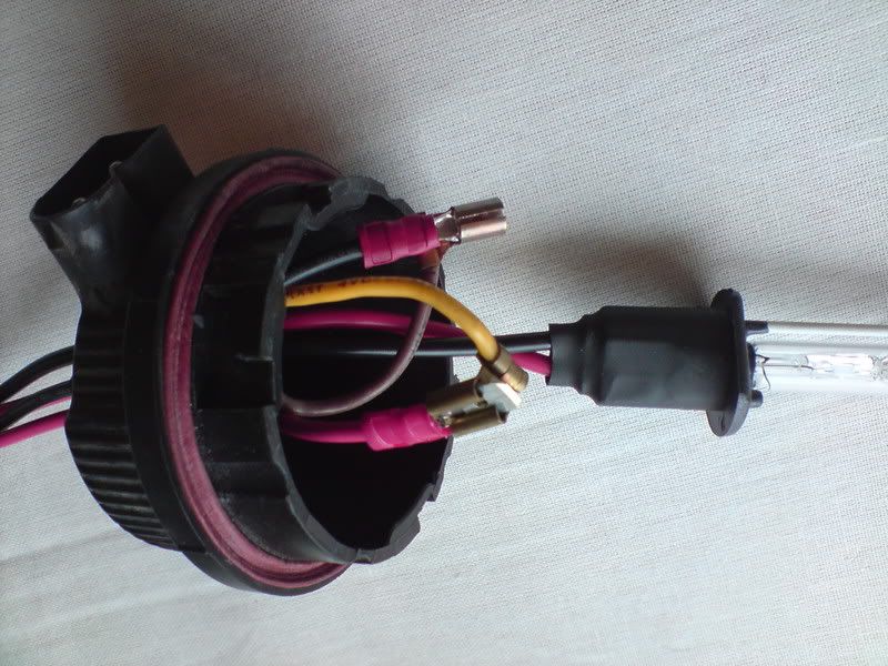

    Now the fun bit, feed the bulb through the hole (25mm) and fit the grommet, making sure its tight and seals well.
    Once the grommet is fitted to your satisfaction then connect the wiring inside the cap so your ready to plug it back into the BMW loom once the cap is re-fitted
    Craig

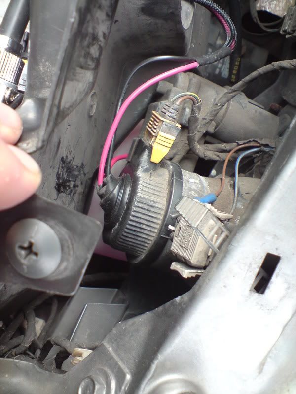

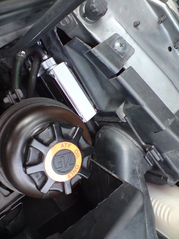

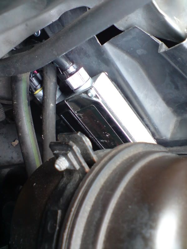

    Next is simply fitting the bulb and cap back on and finding a safe place for your ballast...
    Craig

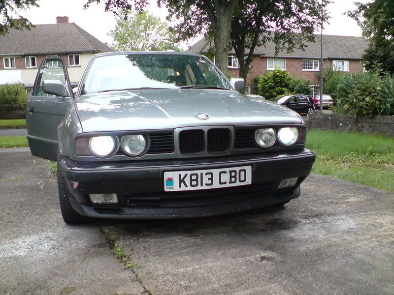

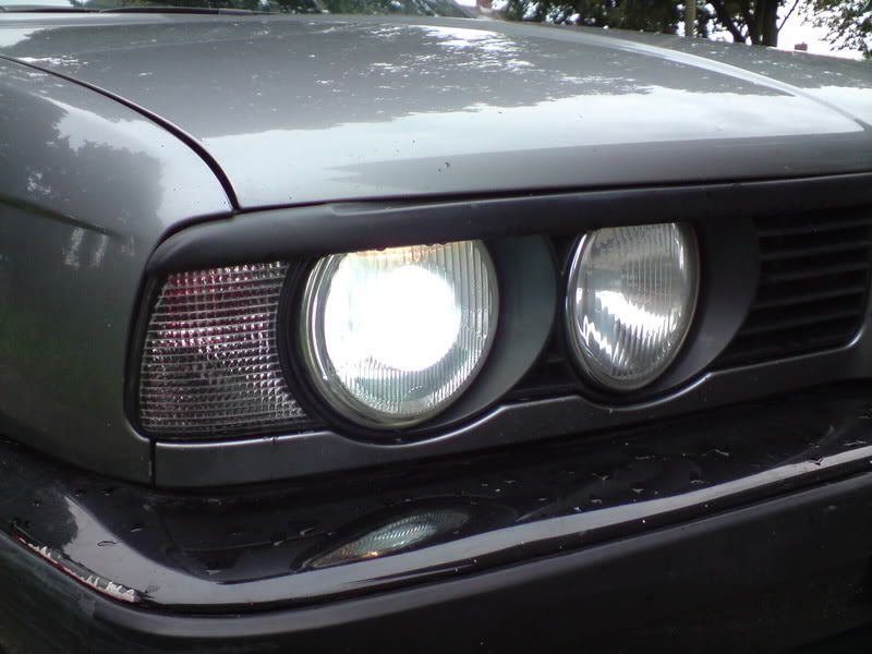

    Plug the loom into the cap and hey presto, you now have HIDs fitted!
    *Word of warning, when you first turn them on, make sure your car is started first and idling steady so the ballasts can have a constant voltage for the first charge*
