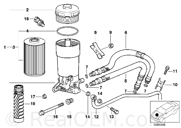

    Also, for the M60 guys:
    I noticed some oil sludge on the pipe that connects the oil filter canister to the oil pan. Anyone replace this before? Looks to be a $65 part on realoem + the associated washers. It doesn't show up on the diagram but there appeared to be a joint in the middle of some kind. Maybe a slip joint with an O-ring?
