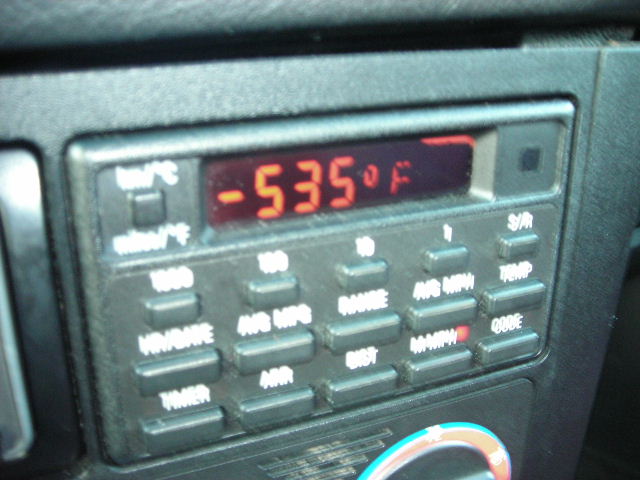

    Ok, so I nearly drove off the road when I got a cold temp. warning of -535F!(ironic, huh?) It went down to -185 and was at -8 when I last turned the car on to check. Can someone tell me where the outside temp sensor is located and what it looks like? I'm guessing my first bet should be to unplug it and plug it back in again? I can imagine that this is what happens when they go south, no?

    It looks a little bit like a coolant temp sensor. Two wire plug going into it and a brass-like metal piece sticking out of it. Mine was loosely hanging right behind the bumper in the area where the driver's side tow hook cover is.
    The other night mine did something kind of strange too. When the temperature dropped below 39*F, the dash chimed and displayed the temperature on the display. I guess it was my car telling me "OMGWTF, turn on the heater!"

    It plugs into a slot behind the left-side tow hook cover.
    It's supposed to chime when the temp gets below +3 degrees C, to warn you that there may be ice on the road.

    mine chimes at +38 degrees F.Is that programmed from the factory and if so why or can i set it wherever or turn it off?
    1995 540i Manual build 1/95
    That is factory set, you cannot switch it off.
    Unless you disconnect the gong.
