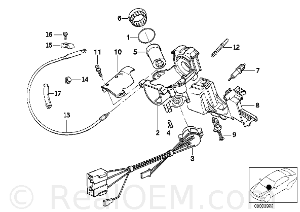

    Does anyone have knowledge of or a link to instructions to remove the steering lock (Item #2) from the steering cloumn? Better yet, the best way to remove the fracture bolts (Item #11) and the pipe clamp? I've searched Bentley and Haynes (useless piece of dung).

    The shear bolts aren't so hard. Use a sharp chisel and bang around the perimeter for a quarter turn or so and they back right out.

    I slotted the bolt with the tapered head so I can remove it. The pictures below may not have what you want to look for. I removed the steering column so I can change out the pedal for the 6 speed conversion. If the steering column is removed, everything will be apparent to you. But you don't need to go that far. Loosening it will get what you want.

    I too, slotted the bolts with a Dremel, which worked really well. I am stuck trying to get the steering lock off of the steering column. It appears that there is a bearing holding the steering lock onto the steering column. I am hesitant to remove the bearing, because it doesn't come out easily. I get it half way out and when I let go, it gets sucked back in....

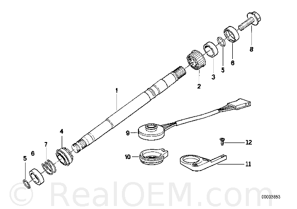

    There is a snap ring (item 5) that needs to be removed before removing the steering spindle bearing (item 2).

    Ah, yes... I had that half way off last night before I gave up. After the snap ring, is it clear sailing?

    Removing the steering lock itself requires a few good pulls. Replacing the snap ring is a bigger pain in the arse than replacing the steering lock. You will need something to pull the steering column out enough to replace the snap ring. The spring (item 7) in my previous post, will pull the steering column down slightly. I used a pry bar to pull and hold the column out enough to replace the snap ring.

    On the '90 E34 at least, you can remove the st. lock assy. without removing the steering column. Use a Dremel with cutoff disk to cut the mild steel guard pieces above the cast st. lock housing, then slot the shear bolt for removal with a flat-blade screwdriver.
    If the st. lock is stiff or jamming, it may be because of a broken alu. pin that is jamming the internal groove. You can inspect this with a flashlight and dental mirror, while still on the car and without removal of the st. wheel. That broken alu. pin is probably the only thing that could jam the internals, and once you get rid of it, all should be well. The pin was probably only in there to keep the internals together for assembly at the factory, and serves no other purpose.
    If you have a heavy duty paper clip and can turn the ig. key to the 60 degree point, you can then remove the ig. lock and internal camshaft, get the broken pin out, and then re-assemble.
