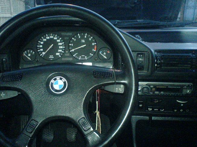

    Default some pictures :)
    some pictures

    Default Bravo!
    Tell us more.....
    How long did it take to do that job?
    More pics?
    What were the difficulties?

    It take me 2 days . To retro-fit the IHKR with the IHKA you need to take out the front interior ( this was a difficulty ) , the ventilation pipes . Then you need to unscrew 5 screws and voila the old IHKR is free then you need to pull her out and to replace it with the IHKA
    P.S. if you had A/C you need to unscrew the A/C pipe
