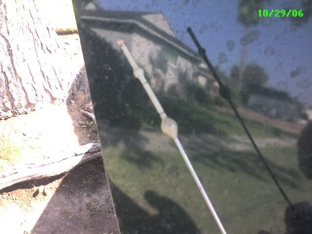

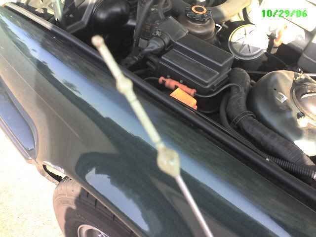

    Ok so I ran the engine to operating temp....pulled and cleaned the stick, then redipped it and this is what I have:
    Now you can't see it that well but I can see a bit of ATF on the top bulge so it coveres the area...I repeated this twice, same result, so I shut off the engine, removed, cleaned and redipped, and reread the stick, and it looked perfect with the fluid clearly between the 2 ticks, unlike it was showing with the engine on (even though I only left it in secral seconds before I re-read it...)
    Ok, so next please haha
