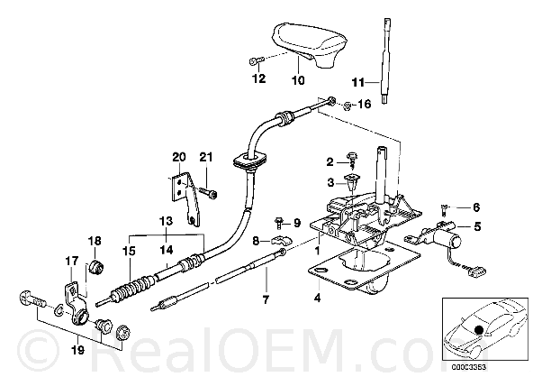

    ditto...sounds like the plastic thingy (#11 in diagram below) that hangs down inside the handle has broken or fallen off its hook in the handle and is jamming in the gate that allows you to move thru the gears.
    Doctor, its time for surgery...we're goin in! Put your emergency brake on, turn ignnition on, pull the gear lever back as far as it will go (or at least to N or D), undo the tiny screw on the front side of the T-handle (faces the radio), then lift the T-handle off. You should see the white plastic thingy (#11) inside the gear lever's shaft. Pull it out and see if it's broken. If it's not, then re-hang it on the little hook inside the T-handle and put everything back together. Then check to see if it moves thru the gate.

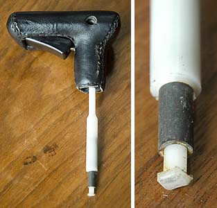

    QSilver7 et al,
    Removed the shifter handle, and the plastic thingie is not broken. (photo below) although the white plastic doesn't go all the way down to the bottom, i have checked the lower edge of it with a magnifier and it's definitely a factory edge, not a place where some white sheared off.
    is the squarish profile of the foot as it should be?
    maybe i am not pushing hard enough, but on reinstalling the shifter handle, i can't get the white rod to go back down into the lever far enough to re-insert the screw.
    do i need to push harder? i've tried rotations of the handle, slight movements of the shift lever, etc and nothing seems to allow it to go back in all the way.
    thoughts, anyone?
    thanks, bruce
