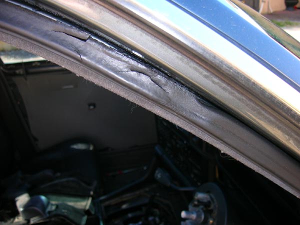

    As seen my door seals were completely ruined, deteriorated, and any speed above 90km gave off wind noise.
    New oem seals were going to cost too much, so for $70 of rubber and "3M Weatherstrip adhesive" and a very sharp scalpel, ive done it myself.
    The last 2 pictures are the new seal that i glued on.
    I cut the old seal off and sandpapered both rubber surfaces with a course grit paper, then applied the glue, it works exactly like a contact adhesive, but much faster.

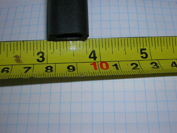

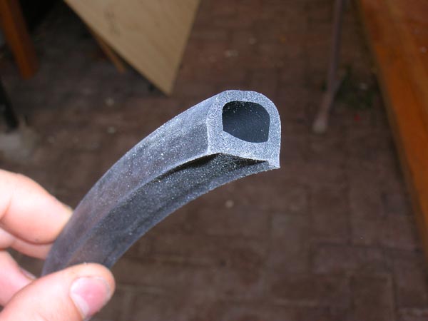

    Here are some shots of the rubber seal, ordinary rubber and foam shops didnt have anything like this.
    You might have to do some hunting, i found the shop quickly because my dad has used them alot over the years due to boat building.
    Ask around and see if you can find any shops that sell high quality marine sound proofing, thats what dad went to this shop for, turns out they have EVERYTHING rubber as well
    edit: let me know if you want more dimensions, or ones in metric, i assumed you (USA?) would want it in inches.
    Oh, and i purchased 3.3m per side and it was just enough.
