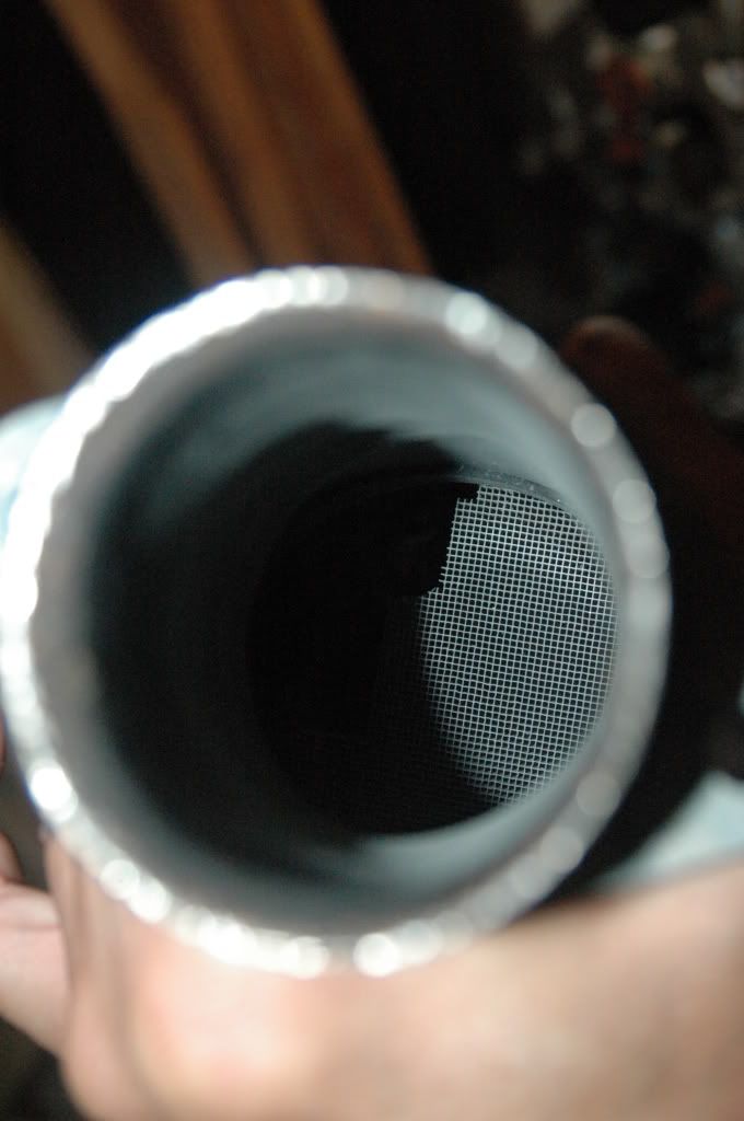

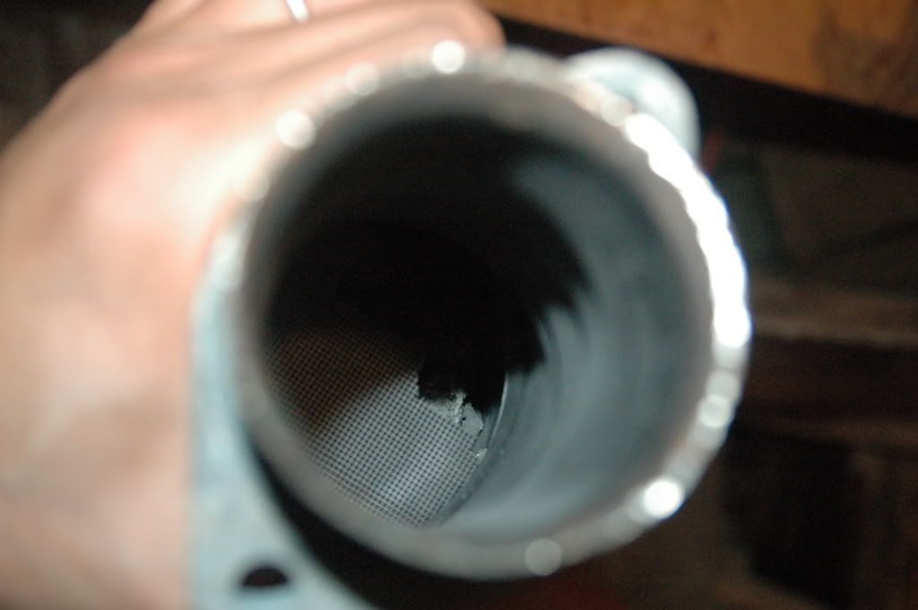

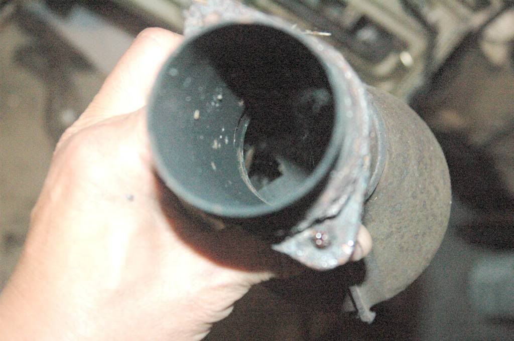

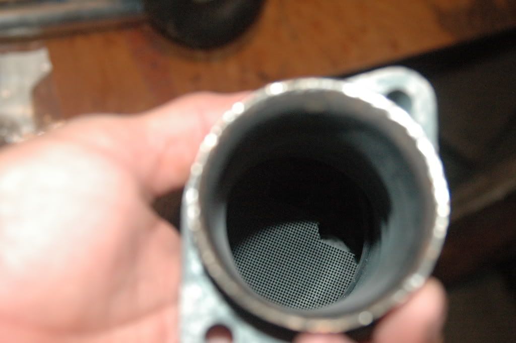

    Both cat converters are removed. I found holes in the honey comb. I am replacing all bolts and nuts with stainless steel ones so removal won't be as painful. Should I get the old ones up? Or are they both toast?
    The driver side cat looking at the upstream opening.
    Another shot.
    Yet another.
    The passenger side one looking at the upstream opening.

    Get Magnaflow cat converter instead... these looks too small. You want to get one just as big as OEM as possible. Talk to their tech support on hoe big you can go. Why do you think OEM is so expensive? They are monster sized.
    Those cats look toasted, if not tampered by previous owner.

    Default The pics you show are the screens, are the honeycombs damaged as well, they
    are deeper in. Before replacing you also need to determine what caused them to fail. Cats usually fail because they overheat from raw fuel hitting them and igniting in the cat.

    Default If you turn them upside down do they rattle and can you get anything
    to fall out the holes in the screens, if not then they are probably ok and the screens just have holes in them.
