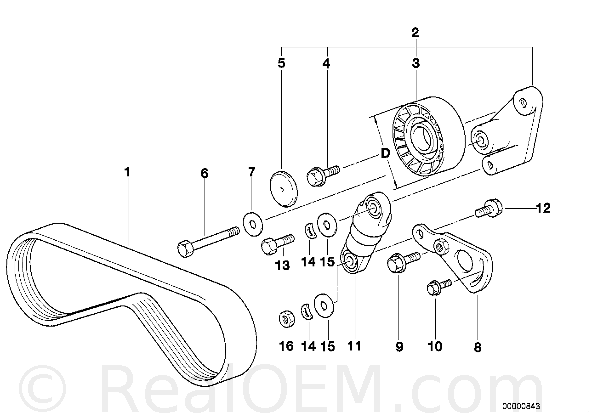

For the M60:
#'s 6 & 3 are the pulley's to check the covers, this is the belt for the Water pump/altenator
A/C Belt:
These would be my first steps.
