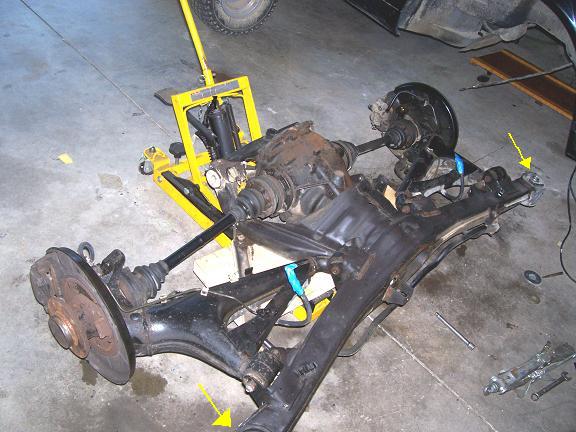

    Based on my experience what you describe make me pinpoint the rear subframe bushing
    http://www.bmwe34.net/e34main/mainte...amebushing.htm

    Let’s see…. Swaying at high speed and a clunk…hmmm… I would say rear subframe bushings.
    Theses bushings locate the subframe square to the body. If they are NFG then the subframe will pivot on its rear center mount and track independently of the body.
    Effectively the rear frame is steering the car.
    I would say half of the folks on this forum have already replaced theirs… and the other half probably needs to have them replaced. It’s a very common problem.
