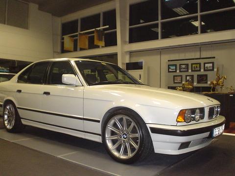

    A while back someone posted a picture of a 525i with 745 wheels. The wheels were 19 but i know you can get the wheels in 18. Here is a picture of the car with the wheels. Can I just put the those wheels on my car or do I need something special. Thanks. Any info on the wheels would be great. Thanks again

    for wheels on e34. make sure the et is between ~13 an 25. 72.56 hub diameter. make sure you have your profile filled out, and use the search function.
