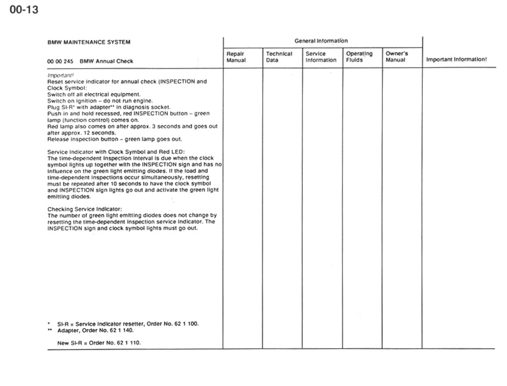

when you next service yourcar make sure you (or whoever) resets the SI(service indicator).Javier I thought he clock was an Annual inspection...it comes on every year on mine...due for annual and ins II

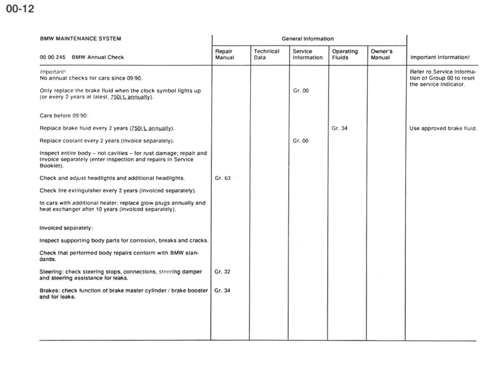

But every two year brake/coolant fluids replacement (except 750il).
Cars before 9/90, report clock inspection every year, but their service requires Brake/coolant fluids replaced every other annual inspection. (See attachment).
