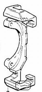

    If none of the other obviouse stuff turns up as a problem, check this. the mount can wear in the circled area in the picture and allow the pad to slide up and down with the rotor making a bang or clunk sound. remove the caliper and make sure the pad can't move in the mount. If it can, remove the pad a lay it on a hard surface. the take a prick punch and hammer it near the edge of the backing plate to swedge the metal outwards and make the backing plate slightly longer. make sure you only swedge one end of the pad that will not take any load under forward braking. File it back if you go to far.
