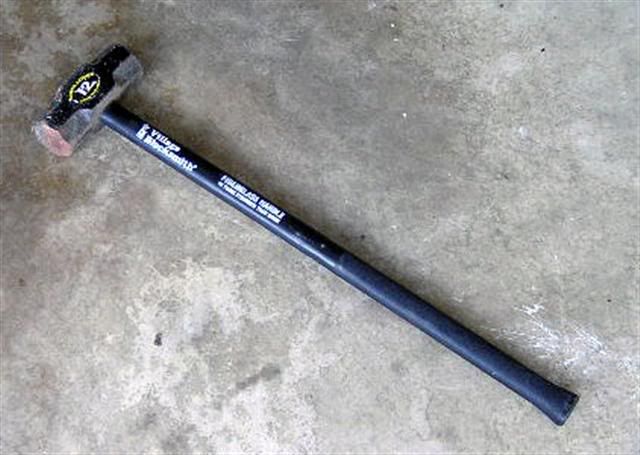

    Default Need to borrow one?
    If this won't do the job, Dacoyote has a bigger one.
