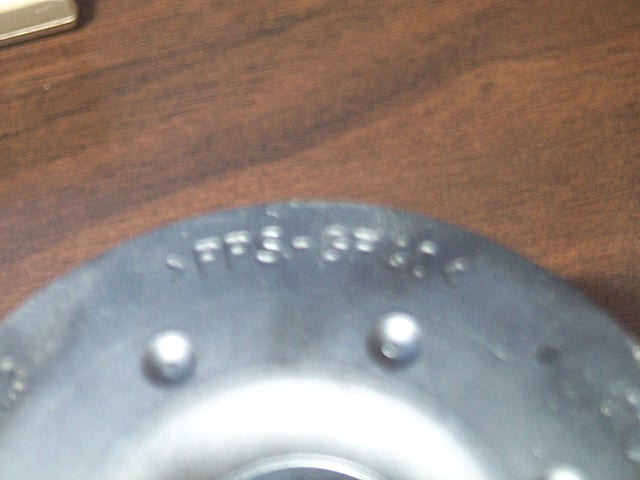

I dashed up to Leith BMW today at lunch to get the pump for tonight's repair work. Please tell me my eyes are tricking me...
That's a glass-filled polyphenylene sulfide...hope it can hold up to the temps.
This is an emergency fitment, and BMW does offer 2-year parts and labor, lifetime parts. So Michael, I think we can safely install this pump on your car; just tuck the receipt in the car somewhere that it won't get lost.

pps gf40 which is glass fiber reinforced rather than glass filledpps gf40 retains its mechanical properties up to 425F so if you get it that hot and haven't barbecued the rest of the motor then you better replace the pump...

Yes, I think it will do fine; I was just shocked to see plastic again![]()

I specifically gave them the VIN GK48410. Got the new pump, didn't have the old one out yet for reference. The hole pattern is the same, but the WEEP HOLE placement is interfering with the pulse ring.
The correct part number for this vintage of car should be 11 51 7 527 799. They gave me 11 51 7 527 910. Still for a 525, just the wrong series.
