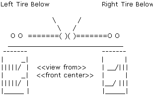

    Alright, need help.
    Have had a few moments of less than brilliance, hope this is one of them and an easy fix.
    Cause the light's not going on right now....the one in my head.
    Michelin Pilot Primacy tires, almost new, came w/the style 5's.
    all 4 mounted w/ "OUTSIDE" written on the outside of the tire so I can read it.
    As viewed from front of the car it looks like my magic art below.
    From the center of the car left tire treads go OUT then DOWN.
    Whereas from the center of the car the right tire treads OUT then UP.
    Shouldn't they look symmetrical?
    I've played mind games on where to move what tires, because each says "outside" on the outside treadwall.
    If it makes it easier, same situation on rear tires...
    Losing my mind (ASCII art will also do that.. ) Please help.

    Do they have rotational arrows on them?? Showing which SIDE of the car the tire mounts on??? They will have either an arrow showing the direction of rotation, and/OR a marking showing "left" or "right" side of the car.
    If not, I wouldn't worry about it.

    try switching the front left with the right rear, or the front right with the left rear. My brother has directional tires on his acura and it does matter which side the go on.
    Edit: And since they are symmetrical, i would guess this to be the case.

    This is an asymetrical, non-directional tire. As long as "outside" is on lug side of wheel you're good to go.

    Default Bret, nope don't see either...
    ....left/right or directional arrows...
    just imagine sould look symmetrical vice one "pointing" up and the other "down" when viewed from front... here's a pic of the tread from michelin website...

    The official description of that tire says it is "Assymetrical" tread- so what you are seeing is normal.
    There are not that many tires out there that have directional tread.......and those that do are sold in pairs- 2 lefts + 2 rights per car.
    It sounds like you got these tires used as part of a wheel/tire deal, but just FYI....
    Bret.
    4,894
    Those tires are asymmetrical... that is the way it is supposed to be... The word "Outside" is outside on each side. and it would look reversed of other side...
    Think of the two tires as a set side by side... looks like one tire.
