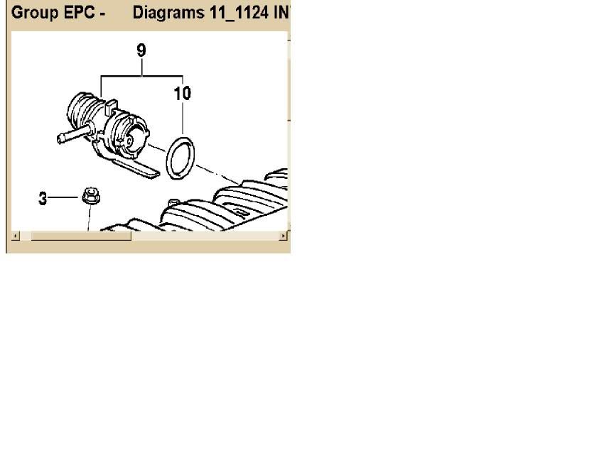

That is the plastic intermediary between the manifold and the idle control valve. The small nipple leads to the crank case ventilation track up near that cam cover. As far as I know, it should not flop around. This could mean your intermediary pipe is broken or the manifold mount point is broken. Check it out, do you have idle issues?
