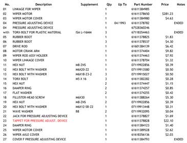

    Thanks Jeff- I have been... but no luck yet. To clarify things, I'll post some info from the realoem ETK. As you can see below, there is no bush (unless it is the one pressed into the main linkage (part #01).

    Incidentally, here is one of the best technical info pages I found terribly interesting on the subject. Here is another (also from Sean & Johan's site) on the more complicated wiper system fitted to many euro and all top-e32 and e34 models - but beware, parts may be similar but are not all common between e32 and e34). This last link one helps people to understand the Pressure Adjusting Device (Part #04).
    The PAD on mine jammed up so I took it out, dismantled and re-greased it, now it works like a trooper and gives a nice consistent wipe. Note that when dismantling one should take care- especially if yours is jammed (in fact I'd check out a good one to get the right positions set before putting the jammed one back together) Doing so risks pressuring the device internally as it winds up (once you are driving)- and as it is designed to do at high speed.
    If not jammed, one should take care not change the position of the cam that operates the microswitch. When reinstalling the nylon worm gear (after greasing) one shoud wind the gear down to the lowest point before installing the black cover plate (with a new gasket of course (make your own ) so it doesn't fill up with water, corode internally and jam up again!
    This PAD can also contribute to the bonnet bash problem if yours winds itself up somehow and won't give way (jams), in fact it might even cause the arm to bend and possibly scratch the bottom of the windscreen.
    BTW; tools needed to dismantle- 7, 10 and 13mm socket with mini ratchet and extension bar. T-15 torx head screwdriver and also a 5mm allen key, 4 or 5mm flat blade screwdriver. Time and patience, especially removing the blower unit if removing the main wiper linkage (something I have not had to do servicing the motors)
