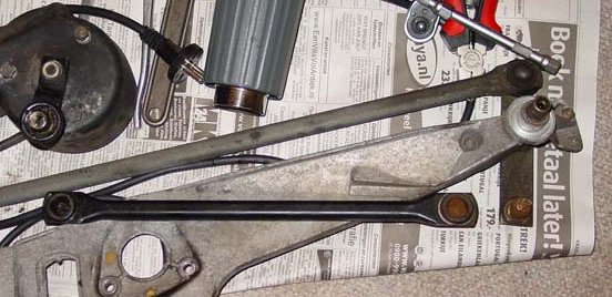

    Default Here is the photo and a suggestion
    Contacted David by e-mail and his advice is as follows below. Will try the approach he suggests. For reference found this photo on the E32 wbsite. It shows the linkage and the "round" splined shaft (which is rusted in the photo) on the botton right. I have tried installing the replacement linkage without reomving the entire assembly (as was done in the photo) but space is limited. It may be necessary to remove the wiper assembly in order to grab the linkage and rock it as suggested in David's reply.
    Hi there
    My inclination is to advise you to persevere with the
    rocking motion but to use a silicon or similar
    lubricant, perhaps. I too tried to use a G Clamp at
    first, with similar results to you!! I then asked a
    BMW mechanic who told me about the rocking system and
    it definitely does work. As you probably appreciate (
    but which at first I didnt, the sockets are made of
    polythene (at first I thought they were some sort of
    soft or springy metal due to the grey colour) BMW do
    put a smear of grease on them, but I think going
    overboard with the lube is the way (and maybe only
    way) to do it. perhaps if necessary ensure that the
    base of the ball is well supported too so you get a
    good purchase between the ball and the rocked socket
    hope that helps!
    Regards
    david
