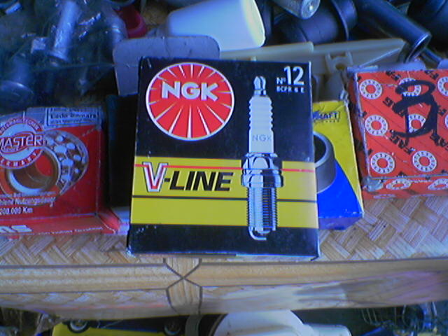

    Do you know about BKR6EY and BPR6EY NGK plugs? Attached is a picture of one of them. Don't remember of which one.
    Will they fit my engine?
    1994 520i with M50 engine, manual transmission and air conditioner.
    VIN: GG45422
