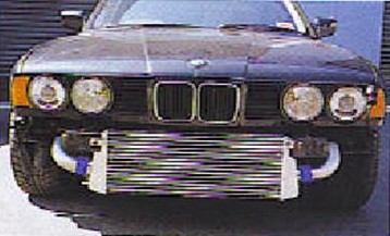

    that would be the best if your running a front mount intercooler, somthing almost impossible with stock manifold, thats why TCD and such run a water intercooler, and i see one on the bay ever blue moon
    Nov 2005
    121
    Quote Originally Posted by kyleN20
    Very good point! The outlet from a FMIC goes up very easy to a throttle body facing the fender, would be hard to route it the other way.
