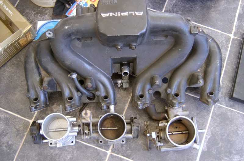

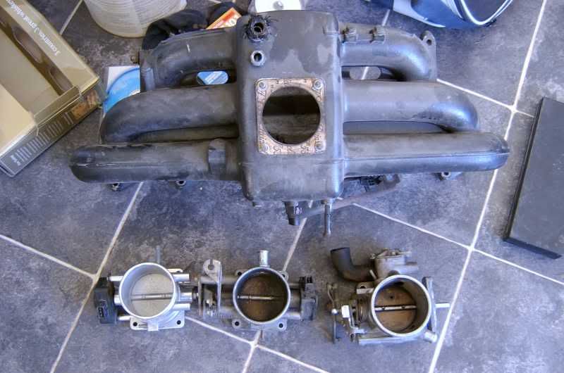

    I only found out about these recently. There are some pics of what it looks like. I think Beetos in Perth has a similar setup, not alpina but the throttle body on the "wrong" side. Please correct me if I'm wrong. I'm thinking for a forced induction (turbo) setup, this is the way to go. Cooler intake temperatures becasue it's no-where near the exhaust. More room for an air-filter as well, me thinks. Maybe the intake in ported, I don't know. Anyway, how popular are they in the USA, becasue I've never heard of them in Australia and I've never heard of a board member here using one. It's Germany or the USA on this item. Comments anyone?
    It's for an M30, off a Alpina B28 E30.

    By the look of the pics, its a cast blank before machining, then machined differently, ie throttle body on the other side. I belive alpina port match the manifold and enlarge the throttle body to 68 mm and match the holes, i got my throttle body for my e34 535ia machined locally in coffs hbr bigkriss, any good machinist can do it for you, you could possibly weld a standard manifold and reposition the throttle body to the other side,hope this is of some help to you

    My set up is a fairly extensively modded stock manifold. I have the original throttle body closed off with a plate that mounts a idle air motor block. The other side is machined to accept a 1000cfm 4 plate throttle body (the v8 efi 4plate system). From there, a special hat is used to route the intake forward to the intercooler. This set up flows a lot of air and gives good throttle control with the turbo. With a single plate the boost would run away with itself at small throttle opening, with the 1000cfm 4 plate, it only opens two plates at small throttle openings with means you can modulate the power better, and flows a **** load of air.

    This is my throttle body, its by EFI hardware and there are blanking plugs fitted where the injectors are shown. Its not a straightforward fit and needs a fair amount of custom fab work.
