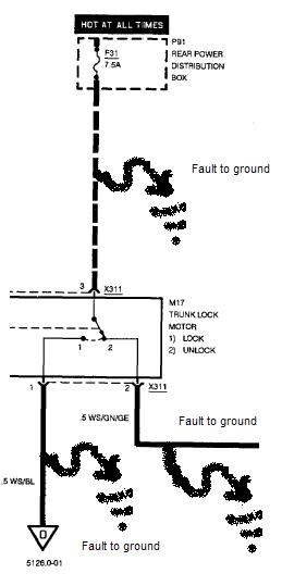

    Default The most probable cause for Fuse F31 to blow is ...
    a hinge harness damaged. You may be lucky and replace fuse not having an issue for a long time, but as soon as harness grounds again the proper wire, you blow fuse again, and issue comes back.
    This picture shows the location of the fault in the the hinge harness.
    Any of the three wires (Red/Black, White/blue, or White/Gren/Yellow) may cause F31 to blow if wire is grounded, and GM will loose immediately confirmation of locked trunk, causing the twice lock order requirement. This can be confirmed also as trunk lock will stop working normally (can not lock car trough trunk lock cylinder).
    This picture shows the location of the fault in the hinge harness.

    Quote Originally Posted by Javier
