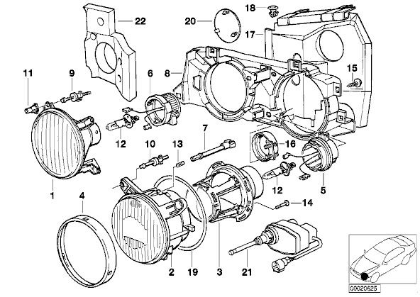

    looks like the bucket on the left side is definetely broken. Is there a motor at the back of the elipsoid or is there a motor that moves the bulb.
    Either way it has to be replaced, and I'm wondering if I can even get one...or two.
    Number 21. Do you think it's still avail? Still $106 bucks?
    I was wondering if I got some hella smileys could my adjusting motor just plug into it or is mine a special bucket.

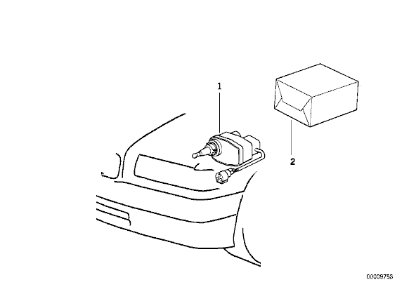

    retrofit aim control shows $210?
    http://www.realoem.com/bmw/showparts...20&hg=63&fg=95

    Usually only the Headlight Adjuster Socket breaks. The complete dip light is moved, see the black plastic sockets which hold it. Maybe they are just broken and the headlight is loose.
    The motor can be of course still ordered. But if it does not work: check first if you get power to it. If yes, disassemble it and see if you get it working again. Sometimes it even helps if you switch it many times from one side to the other end, so that the motor get's 'free' again.
    You can also use a motor from an E32, same headlights as E34.
    One additional thing: the difference in non adjustable and adjustable are how many of these plastic sockets hold the headlight.
    See in the parts catalog and compare the 2 systems.
    Usually all Hella lights come with headlight adjustment possibility and even the aftermarket ones, because this is required by law in Europe, unless you have LAD, where the rear of the car is always adjusted.
    The question is, do you have the sytem already or not?
    If you only bought new headlights, then you need of course the retrofit system. And that is expensive.
