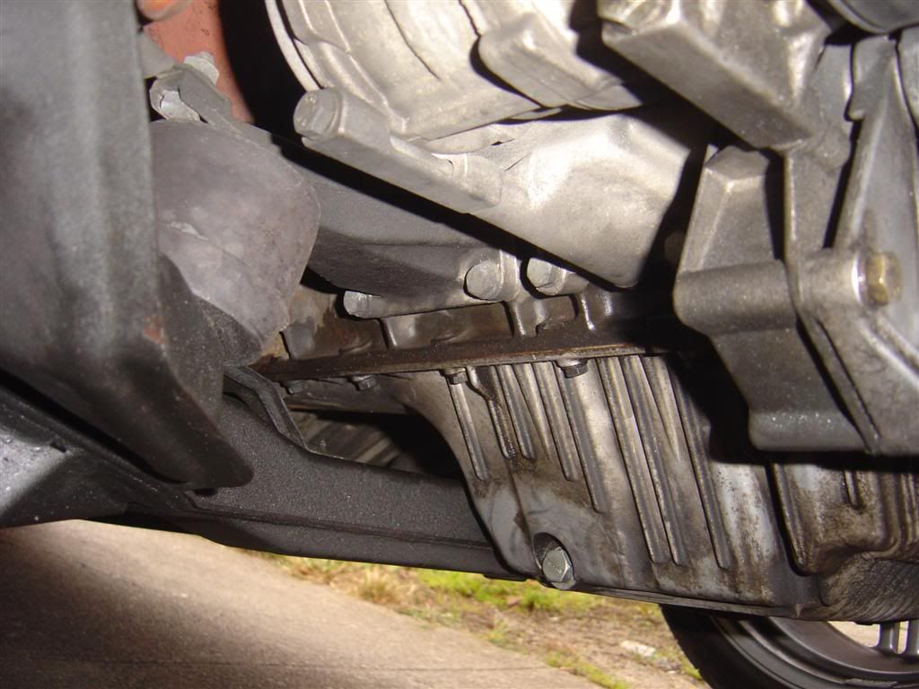

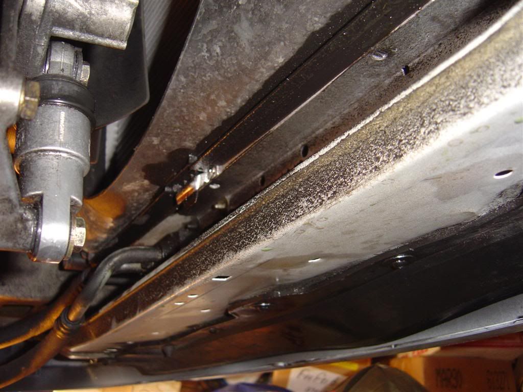

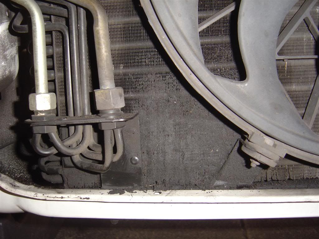

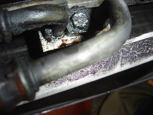

Josh, if you can get a pressure tester on the system, you'll probably be able to find that coolant leak ASAP. Use one that does about 2 bar (~ 30psi).
Those are the auto tranny cooler lines. There should be O rings at the "screw box" that mates the cooler to the lines. Pretty easy fix if the lines themselves and the cooler itself are okay.

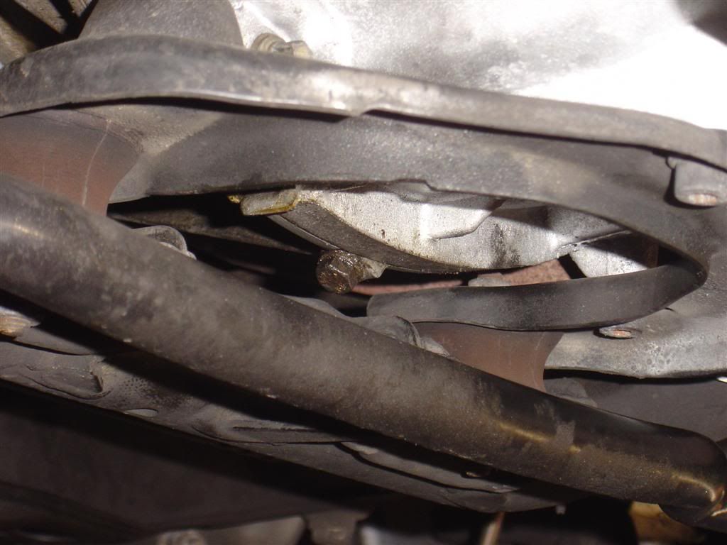

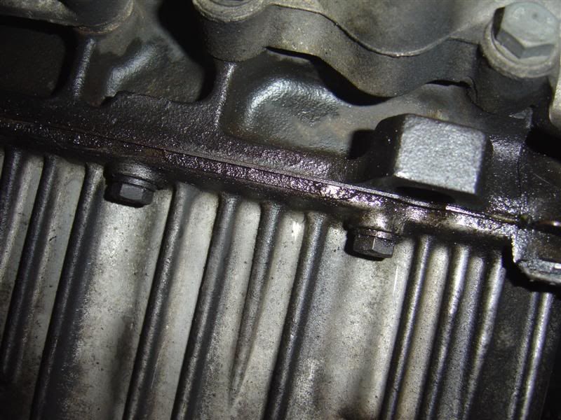

Bellhousing drip could be anything -- oil thrown back from the leak by the pan or a leak in the rear main. Rule out the rear main by looking up into the bellhousing -- there should be other evidence. Take a few more wider shots of the pan itself.
