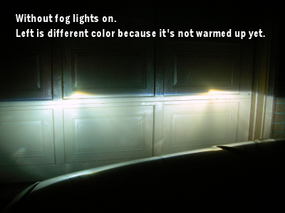

    Two kits. Two different cars. One ballast on each set died within the first few days. Warranty was great though and replaced both. Pictures to come...

    The headlamps are US spec ellips
