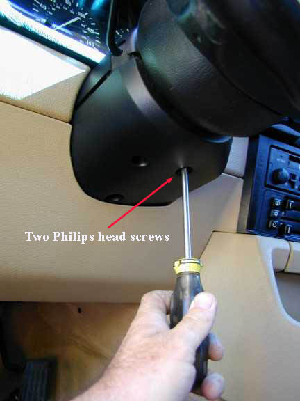

    2. Wait a few minutes for the airbag to discharge, then remove the 2 philips screws that hold the steering column
    cover on the bottom.

    Make sure you disconnected the batteryThen you remove the bottom cover on the steering column. When thats removed you will see a orange connector.
    Thats the airbag connector. Squeeze the clip ends and seperate the connector. Remove the end that goes to the steering
    wheel from the post its fastened to.
