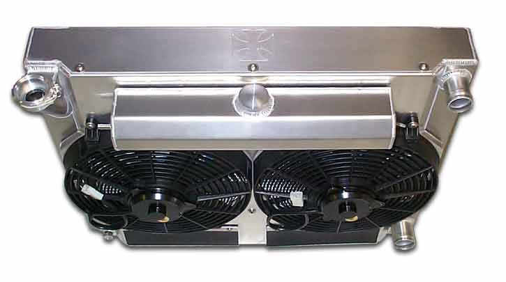

    Default if you want to go for it, buy the REAL stuff
    Fully removable low profile aluminum shroud
    -High performance puller fans
    -Stainless steel hardware
    more details here
